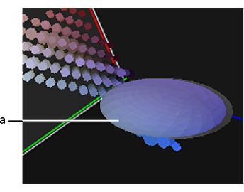

The tolerance sample in the RGB viewer is represented as an ellipsoid by default. The ellipsoid shows you the location, in RGB colour space, of the range of colours included in the sample. All colours in the tolerance ellipsoid are black on the matte.
(a) Tolerance ellipsoid  

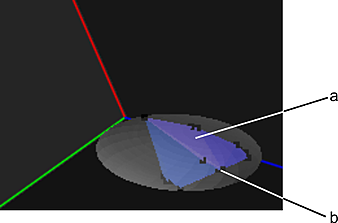

The tolerance ellipsoid surrounds the exact colours sampled, which are connected in RGB space to form a 3D convex hull. You can see the convex hull in the ellipsoid by changing the tolerance display.

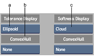

  2. In the Tolerance Display box, set the tolerance display to Cloud, which is semi-transparent.
    (a) Tolerance Convex Hull box  (b) Tolerance Display box  (c) Softness Display box  
    Note: To learn more about controlling the display of the tolerance sample, see Changing the Display of Key Elements.
  3. In the Softness Display box, set the softness display to None.

  4. Set the Tolerance Convex Hull box to Vert&Surf.
    You can now see the convex hull, with vertices indicating the exact colour areas sampled.
    (a) Convex hull  (b) Convex hull vertices  
    The convex hull contains the exact colour values of the tolerance sample, while the ellipsoid represents the actual area in which corresponding pixels will be black in the matte. The 3D Keyer uses the ellipsoid rather than the convex hull to determine the keyed out area because it is much faster to calculate.
