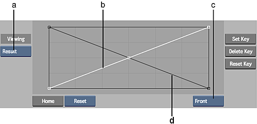

  1. Click the Result node in the pipeline.
    The Matte Curves menu appears.
    (a) Result box  (b) Front matte curve  (c) Matte box  (d) View box  (e) Back matte curve  
  2. Select Result view from the Result box. This allows you to select a particular image to view as you adjust the curve.
  3. From the Result box, select the image you want to view as you adjust the curves.

  4. To adjust the luminance curve for the front matte, select Front from the Matte box. To adjust the back matte curve, select Back. Alternatively, click a curve to select it.

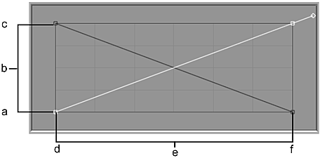

    (a) 255 (White)  (b) Output (remapping of luminance values)  (c) 0 (Black)  (d) 0 (Black)  (e) Input (current luminance values)  (f) 255 (White)  
    In Move edit mode, click a point to display its tangent handle and drag the handle to adjust the curve. Use other modes in the Tools box (Add, Delete, or Break, for example) to further adjust the curve, adding or deleting points, or breaking tangent handles as needed.
