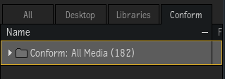

You can also manually add clips from the Media Panel to the Conform Media folder: drag-and-drop them to the Conform Media folder. This does not clear already present sources.
Tip: Clip the top-left Conform tab for the Media Panel to display only the sources.

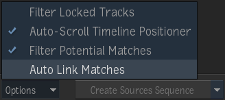

Options Auto Link Matches automatically links events with a single match clip (green checkmark) after the Search Location is set or modified.
If you need more control over how Conform links sources to events, disable this option.
