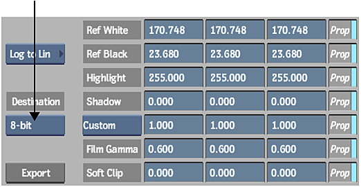

Choosing an Operator Type
  1. Select an output bit-depth option from the Destination box in the LUT Editor.

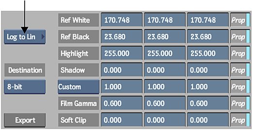

  2. Select one of the manual options from the LUT Type box.
    Select:To:
    Colour TransformApply a colour transform based on the Academy/ASC colour transform XML format, as well as several other supported LUT and transform formats.
    PhotoMapBegin with a default curve for tone mapping.
    3D LUTImport a 3D LUT. Note that this mode is superseded by Colour Transform.
    1D LUTImport a 1D LUT. Note that some 1D LUTs are intended for integer values and others are intended for floating-point values. Most 1D LUTs will also load in Colour Transform mode.
    EXR DisplayBegin with a default curve for tone mapping.
    GammaBegin with a default curve for applying or removing gamma or offsets.
    Lin to LogBegin with a default curve for converting linear or video data to logarithmic data.
    Log to LinBegin with a default curve for converting logarithmic data to linear or video data.
