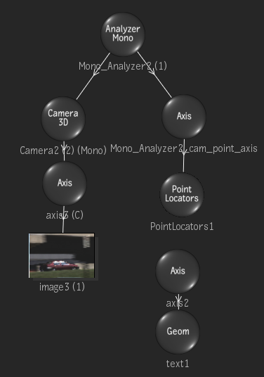

In the schematic, you can see that the axis of a point locators object is automatically attached to the Analyzer node. You can then add objects (such as a 3D text geometry), and use the Point Locators menu settings to help you position the object into your scene.
Note: If the point locators object is moving (that is, you performed object tracking), you'll need to parent the point locators object to the object you want to position, so that it can properly follow the movement of the point locators.
