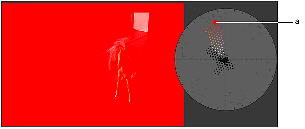

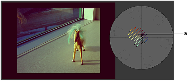

When working with 16-bit floating point images in the Colour Warper, you can plot colours outside of the 0 to 1 range. Even when working with integer images, clamped colour information (colours that go beyond the RGB range) can be retrieved using the Colour Warper controls.
(a) Clamped colour
(a) Colour information restored
