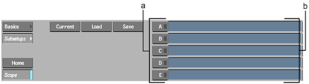

Subsetups are Colour Warper setups selected at a specific moment at a specific frame. Subsetups are for the current frame only and do not include entire animations. You can select up to ten subsetups and compare colour corrections in other subsetups. You can save and load a group of subsetups.
Note: The group of subsetups loaded affects all Colour Warper nodes in the current setup since subsetups are shared between Colour Warper nodes. Ten subsetups (A-J) constitute a group.
Use the Subsetups menu to:
  • Selectively store intermediate setups.
  • Compare any subsetup to the current setup.
  • Share subsetups between Colour Warper nodes.
  • Save and load a group of subsetups.
(a) Subsetup buttons (b) Subsetup fields
