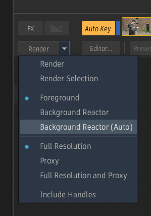

Automatic Background Rendering
When in the Conform, Timeline, and Effects environments, Flame can automatically render Transitions and Timeline FX in the background.
To enable automatic background rendering, select Background Reactor (Auto) from the Render drop-down button.
With Background Reactor (Auto) selected, the text of the Render button changes from white to blue.
Click Reactor to send the whole sequence to background rendering.
Click Reactor Sel to send only the selected segments to background rendering.
