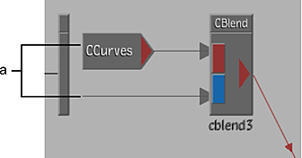

A blend node is essentially a container that you can use to create a “mini-composite” at different parts of the pipeline. CBlend and MBlend nodes each comprise one or more layers that include the components needed for a composite: a front, matte, and back component. These components are referred to as pipes, and they may contain as many nodes as needed to create the desired image.
(a) The Front and Matte pipes of the blend node constitute one layer.
Note: The back component is not represented visually as it is applied automatically to the composite.
