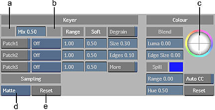

(a) Primary Sample colour pot (b) Secondary Sample colour pot (c) Edge Balance trackball (d) Sampling box (e) Reset button
