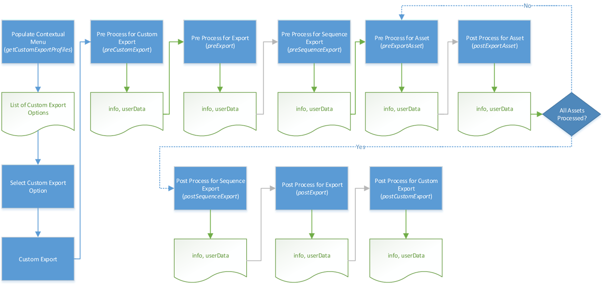

exportHook.py
exportHook.py contains all the hooks related to exporting clips.
These hooks are used during export operations from the application.
Export hooks are called in the following order:
  1. pre_custom_export Optional. Called if required by get_custom_export_profiles. Called when the context menu item defined by getCustomExportProfiles is selected.
  2. pre_export Always called. In a regular export, pre_export is called as the Export window is displayed. In a custom export, called after pre_custom_export.
  3. pre_export_sequence Always called. Called before writing the sequence.
  4. pre_export_asset Always called. When it is called depends on the export option. With Foreground Export, all pre_export_asset are called for each assets immediately in one go. With Background Export, each pre_export_asset is called as each asset job is submitted to Backburner.
  5. post_export_asset Always called. Called after an asset is written. Can be done in backburner as determined by use BackburnerPostExportAsset.
  6. post_export_sequence Always called. Called after post_export_asset.
  7. post_export Always called. Called after post_export_sequence.
  8. post_custom_export Optional: called if required by get_custom_export_profiles. Called after post_export.
