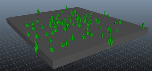

When lighting a scene, sometimes you want to avoid the lighting TD to directly deal with the crowd simulation and rather use Maya objects to locate / visualize where the Crowd Entities currently are. The Golaem Crowd Constraint Behavior provide a way to place Maya objects on Crowd Entities but that'll require to create as many Maya objects as they are Crowd Entities. In the following, we provide a sample code to use and keyframe Maya cubes as Bounding Boxes of the particles representing Crowd Entities.
Example of a Maya cube acting as a bounding box of the crowd
This whole process relies on Maya MEL functions. First you need to copy the following function in your Maya scripts and make sure it's sourced correctly. It takes the name of an object to track (in our case a particle system), the name of the cube to use as bounding box and if you want the bounding box vertices to be keyframed:
