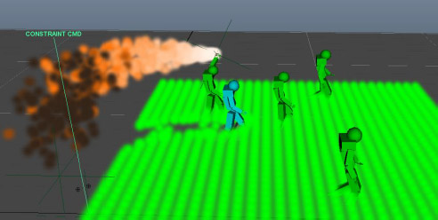

This behavior lets you interact with other Maya objects, generating footsteps, making simple cloth, dust, and various effects. The animation generated on the constrained objects can be keyframed by the behavior so the result can be provided to people who do not use Golaem Crowd.
Example of entities interacting with NParticles, using the Constraint Behavior

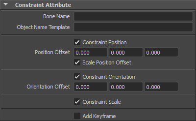

Constraint Attributes
Constraint Attributes of a Constraint Behavior
| Bone Name | Name of the Bone which position and orientation will be used to constraint the Maya Object. Works with any bone of the character. |
| Object Name Template | Name of the Maya Object which will be constrained to each character. This field may contain special tags such as #pid#, #ps# or #gid# to assign one object per character (e.g. locator#pid# will assign locator1 to the particle of id 1…). If the object does not exist for one particle, a warning message is returned. (see Technical Documentation). |
Position Attributes
| Constraint Position | If checked, the position of the Maya Object will be constrained |
| Position Offset | Maya 3d position offset to apply between the bone position and orientation and the Maya Object |
| Scale Position Offset | If checked, the character scale is applied to the position offset (the final offset being Offset * Character Scale). See Entity Type or Crowd Field for more information about scale. |
Orientation Attributes
| Constraint Orientation | If checked, the orientation of the Maya Object will be constrained |
| Orientation Offset | Maya 3d orientation offset to apply between the bone orientation and the Maya Object |
Scale Attributes
| Contraint Scale | If checked, character scale will be applied to the constrained object. Thus, make sure the scale transformation of your Object has been reset before using it in a Constraint behavior. |
Keyframe Attributes
| Add Keyframe | Generates keyframes (one per frame) on the attached objects so that they can be animated without a Golaem Crowd simulation (e.g. to be passed to other departement not using Golaem Crowd) |
