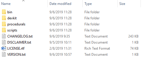

Installing the Golaem For Houdini plug-in
The Golaem for Houdini plug-in can be found can be found in the extension section of the Golaem product in your Autodesk account and it has the following directory structure:
