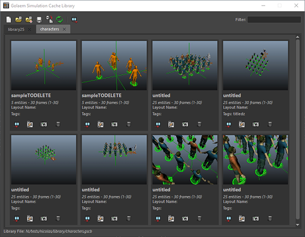

Create your Crowd Simulation within Maya using Golaem . In our example we will use the locomotion scene from the Golaem Crowd Samples. Once the simulation is done, open the Simulation Exporter to export the Simulation Cache. Once the Simulation Cache will be exported, a Simulation Cache Library File (.gscb) will be created in the same directory than the Simulation Cache. It is also possible to add the exported simulation to an existing Simulation Cache Library File using the Library Tool.
The Simulation Cache Library File contains useful information about exported simulations such as the export directory, the Character Files used.
