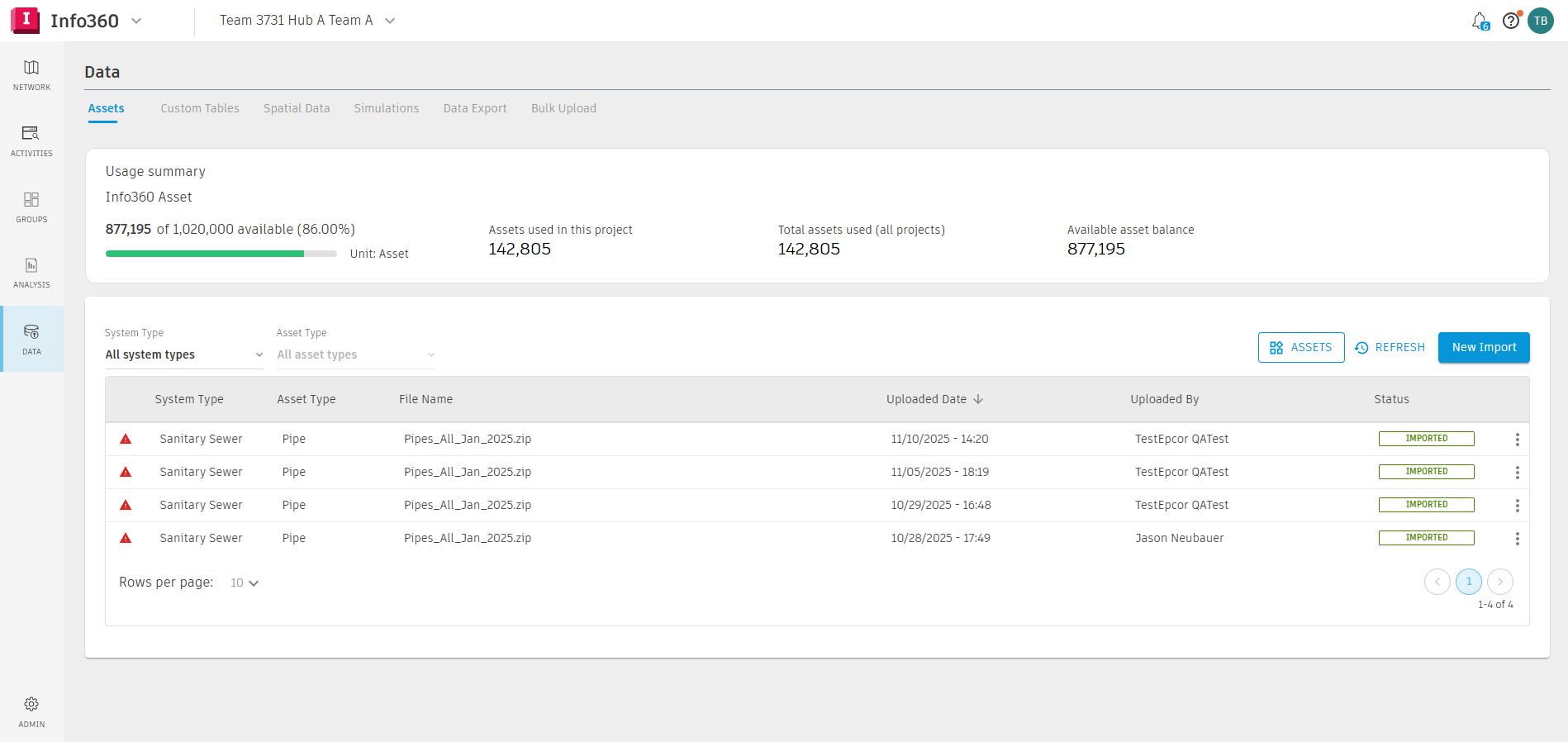

Check Your Capacity
Admins can view current capacity usage, meaning the number of assets used in the current project and the number used in total across all of your team’s projects in two ways:
