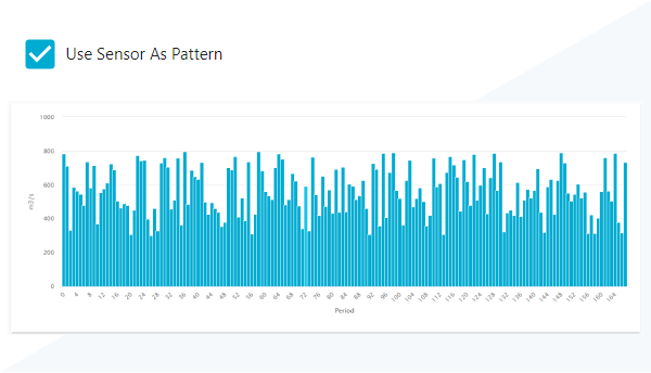

June 23 | The new Use Sensor as Pattern option creates patterns with actual sensor data instead of consolidated, averaged data.
This can be useful for hydraulic model calibration/validation. For example, you can create a pattern with several days' worth of data for use in multi-day gap analysis over a given simulation horizon.
