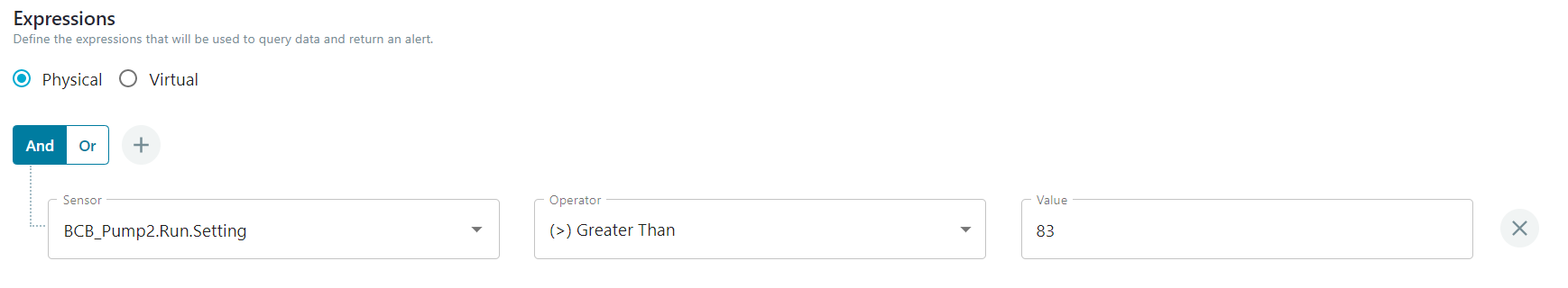

  3. Under Expressions, choose between Physical and Virtual.
    Physical sensors retrieve live sensor data, while Virtual sensors are time series data generated within Info360 Plant (e.g., in an analytic).
  4. Click on the plus sign (+) to define an expression.
  5. Select Sensor.
  6. Select a sensor, operator, and enter a value.
  7. You can add additional expressions if you wish. If you do, choose which logical operator (And / Or) you want to apply.
