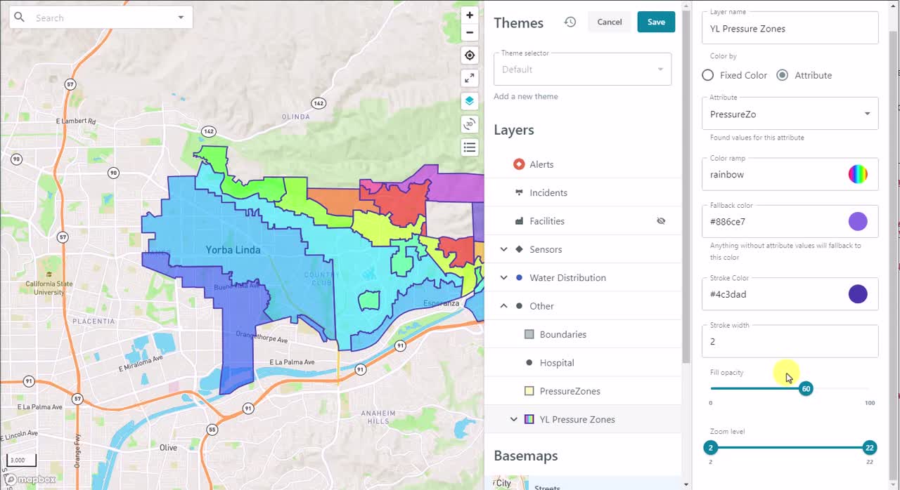

Color by attribute
Color GIS Layers by Attribute
For GIS layers, you can choose to color-code based on one of the available attributes for that layer. For example, for a layer with pressure zones, you could select the attribute 'zone ID' to show each pressure zone in a different color on the map. You can do this in the Theme Editor by selecting Attribute instead of Fixed Color.
For asset layers, there is a set list of attributes to choose from. When you select one, the system will tell you if you have data available for that attribute.
For spatial layers, you can choose from the attributes that you mapped for that layer and that are text strings.

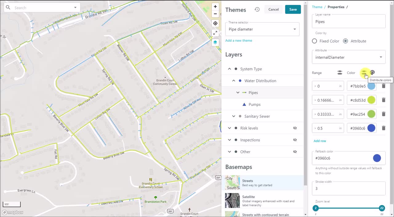

Color by value range
You can also color layers based on a range of numerical values. For example, you can color sensors based on their latest value to easily see how low or high it is. Or, you could color pipes based on an attribute range such as diameter.
You can do this in the Theme Editor by selecting Attribute and then selecting an attribute from the drop-down that has a range of numerical values.
You can add rows to the range and you can use the Distribute Range button to evenly distribute the numbers.
Similarly, you can choose the colors associated to each row or use the Distribute Colors button or Select Gradient for Range button to create a color range.

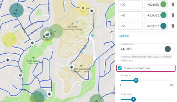

For sensors specifically, you can also choose to display latest sensor values as a heatmap. Mark the Show as a Heatmap option.
