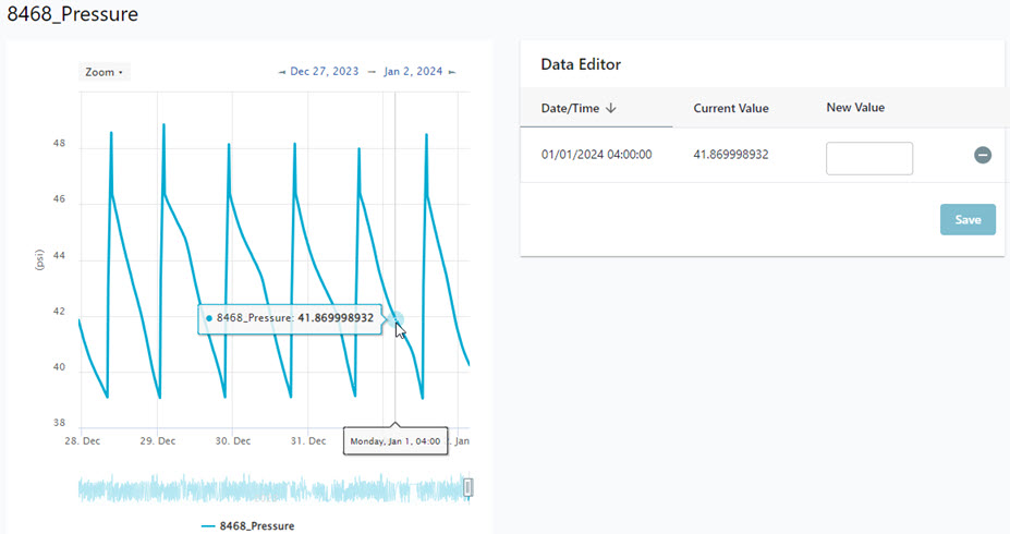

It is possible to manually edit sensor data in Admin
Sensor Configuration if you are an Admin user.
To edit a sensor's data:
- Go to Admin
Sensor Configuration and open the sensor.
- Click on the drop-down arrow beside Save Configuration and select Edit Sensor Data.
- Locate the data point you want to edit on the chart and click on it.
- Enter the New Value and then click Save.
Note: It is not possible to edit sensor data in this way for virtual sensors created from the analytic, mass balance, or ILI tools.
