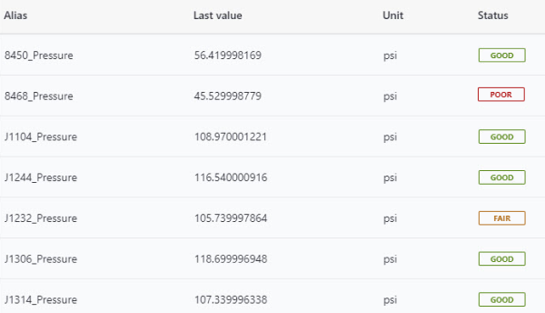

Nov 23 | Info360 Plant now provides a sensor health status so you can check if a sensor is receiving data as expected.
This will help you detect if recalibration is required or if an incident needs to be reported.
You can view these statuses in Admin Sensor Configuration by enabling the Status column.
Sensor health is defined as follows:
  • Good = > 94.9% Uptime
  • Fair = Uptime between 84.9% and 94.9%
  • Poor = < 84.9 % Uptime
You can also view a sensor's health trend for the past 7 days by opening the three dot menu Chart.
