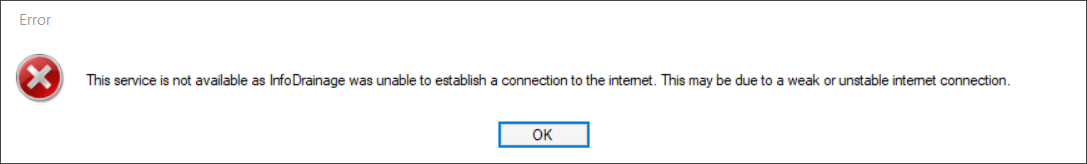

Error Messages
If an error occurs at any point during the cloud analysis process an appropriate error will be displayed.
For example, if internet connection is interrupted whilst attempting analysis the following message will be displayed:
