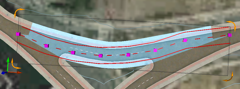

Horizontal manipulators
Horizontal manipulators are available when the model is in plan view.

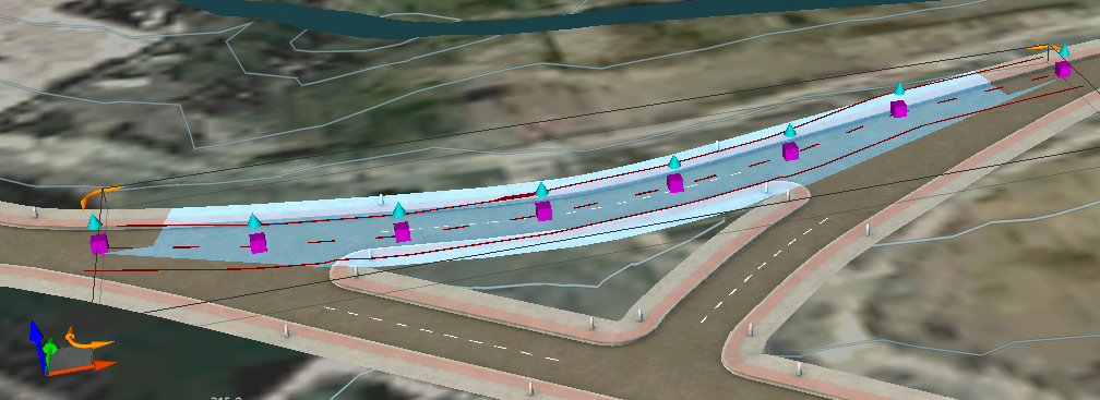

Vertical manipulators
Vertical manipulators are available when the model is pitched at an angle.

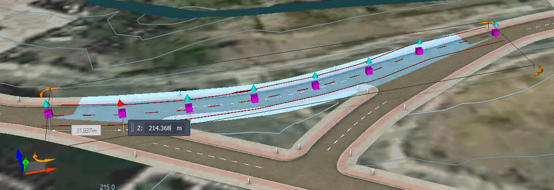

Adjust elevation
Select a vertical manipulator to adjust elevation.
