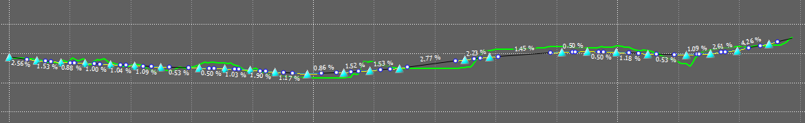

A rough profile before Profile Optimization

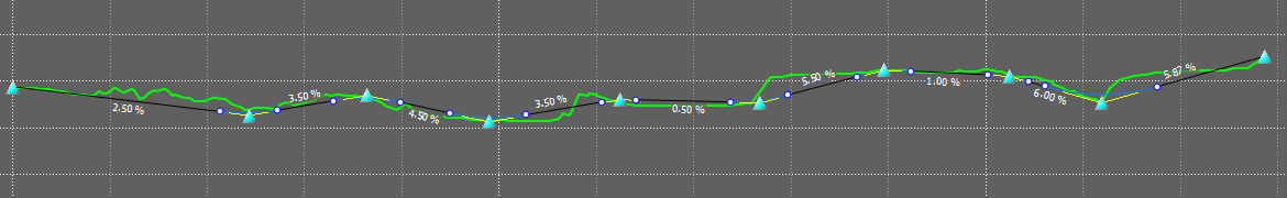

A profile after Profile Optimization
