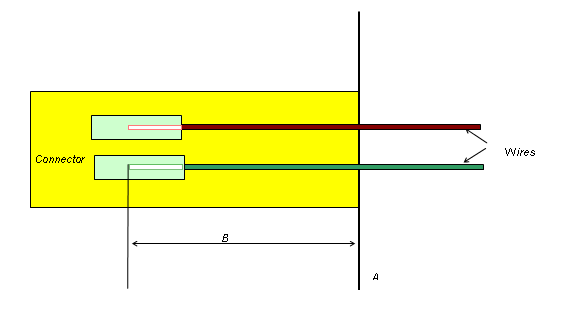

Example 1:
In this example, the connector has an Embedded Length property that is applied to all wire occurrences connected to it.
A: The plane on which all pins of the connector are modeled.
B: The distance between plane A and the point where the inserted wire ends. This is the embedded length value of the electrical component.
Adjusted length = Original wire length + B.

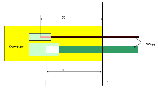

Example 2:
This example shows a complex connector that accepts both large and small wires. Since the large wire's pin cavity is embedded into the connector a different amount than the smaller wire cavity, an embedded length property is placed on the connector. The property value is equal to the most common embedded length for the majority of the pin cavities.
B: The distance between plane A, and the point where the inserted wire ends. For a connector with differing cavity sizes, B could be different for each wire inserted depending on the depth of the cavity. In this example, B could be equal to either B1 or B2.
B1: The distance between plane A and the point where the inserted wire ends for pin cavity B1.
B2: The distance between plane A and the point where the inserted wire ends for pin cavity B2.
Adjusted length of smaller wire = Original wire length + B1
Adjusted length of larger wire = Original wire length + B2
