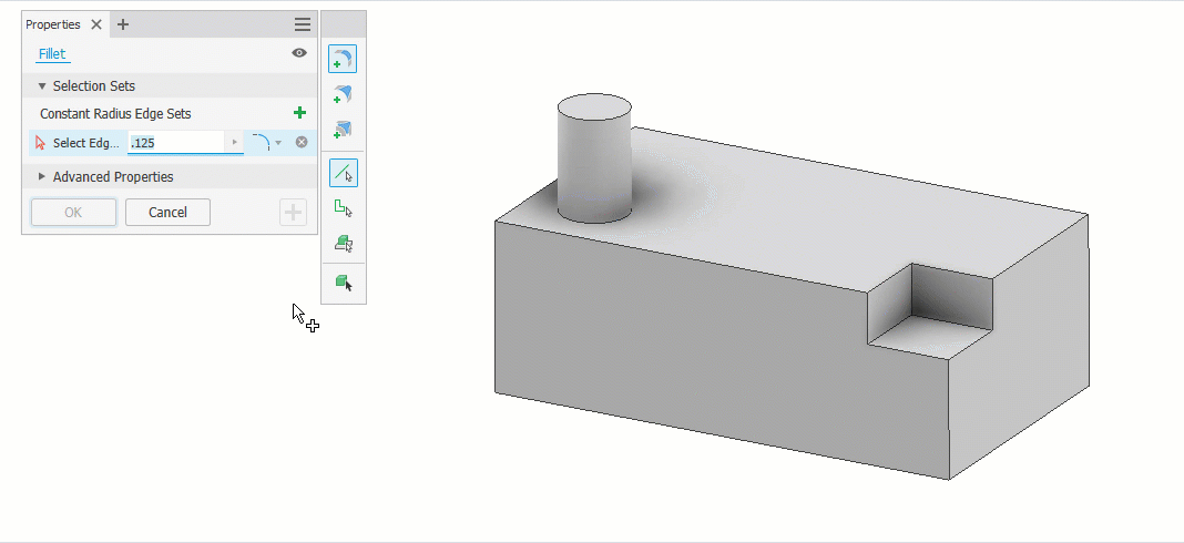

Fillets
The fillet command is moved to the property panel framework and divided into three commands - Fillet, Face Fillet, Full Round Fillet. Legacy fillets are migrated to the appropriate type. Legacy fillet names are not modified during migration.
  • Fillet
    For more information, see To Create Edge Fillets.

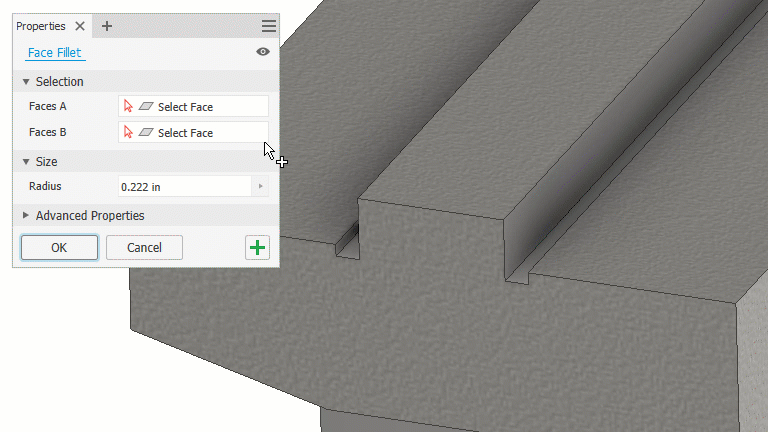

  • Face Fillet
    Adds a fillet feature between two non-adjacent faces of a single solid. If there are contiguous features, these are capped and filled to create the fillet.
    For more information, see To Create Face Fillets.

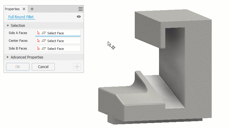

  • Full Round Fillet
    Adds a fillet feature tangent to selected faces or sets of faces.
    For more information, see To Create Full Round Fillets.
