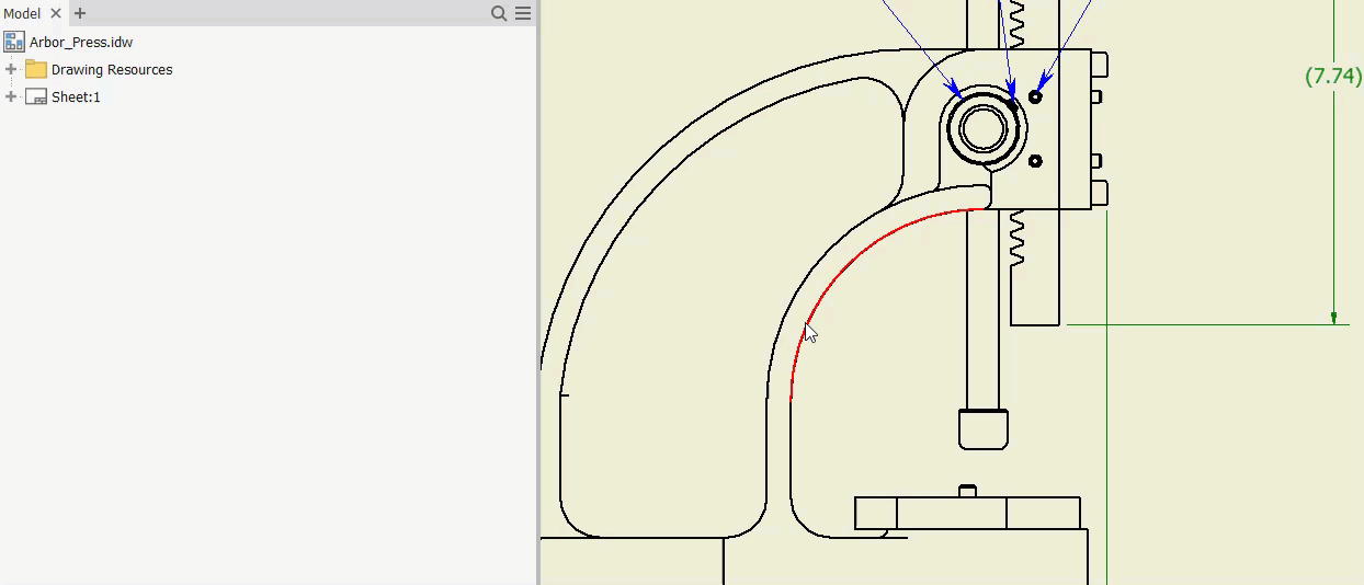

Capture Current State Enhancement
Use the new Capture Current State context menu option to generate iLogic code for the new drawing functions. The code provides a way to access drawing lines and curves in a view, given the names of the corresponding model entities. You can then attach dimensions and annotations to the lines and curves.
For more information, see To Capture Current State of Drawing Curve.
