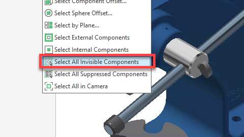

"Select All Invisible Components" command
You can now select all parts within an assembly that are set as Invisible so that I don't have to manually select each individual one in the assembly or browser. Use the newly added "All Invisible Components" option from the Selection drop-down, or the "Select All Invisible Components" in the quick access toolbar, or the right-click with the Shift key.
You can also assign a command shortcut key using the Customize dialog box.
For more about assembly component visibility options see Visibility of assembly components.

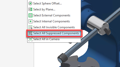

"Select All Suppressed Components" command
A new "Select All Suppressed Components" option enables you to select all suppressed components within an assembly so you can toggle them to be unsuppressed. You can access this option:
  • From the Selection drop-down
  • In the quick access toolbar
  • Right-click with the Shift key
Use the Customize dialog box to assign a command shortcut key to the command.
For more about assembly component suppression options see Suppress elements.

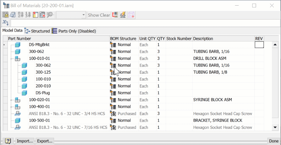

You can now select multiple adjacent or non-adjacent cells and delete their contents.
For more information see To Work with Bill of Materials.

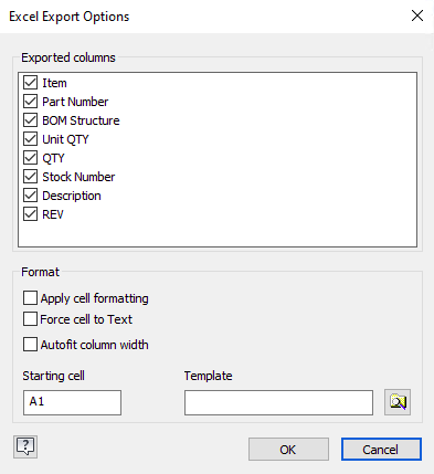

Also, you are now able to specify columns and formatting of Assembly BOM to export. We have aligned the BOM export to be consistent with options available for Parts Lists and Tables. Only the Include Title option isn't available because BOM table doesn't have any customizable title.
For more information see To Export a Bill of Materials to a Spreadsheet or Text file.
