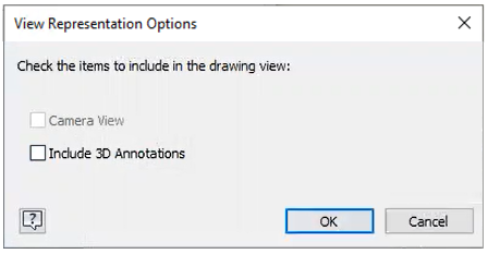

The View Representation Options dialog box is displayed when creating or editing a projected view. The Camera View option is disabled to keep the relationship between the base view and projected view.

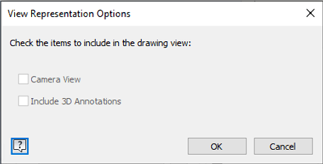

Both options are disabled when creating child views, such as Section View and Detail View, when the camera orientation of the child view does not match the orientation of the drawing view being edited.
