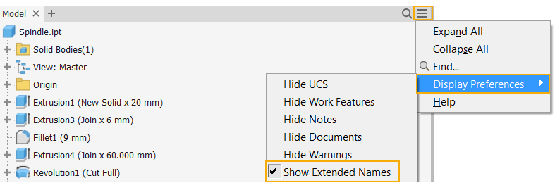

Display Extended Information in Browser Enabled for Multiple Commands
The options, Display extended information after feature node name in browser (available from the Application Options/Parts tab, and Show Extended Name, (available from the Model browser tool's menu) are enhanced to support the following commands:
  • 3D Model Work Features
    • Mirror
    • All workplanes
    • All workpoints
    • All work axis
Note:
Access: From Application Options/Parts tab
Access from Model browser tool's menu
An Inventor® Ideas submission
For more information, see Part Tab Reference (Application Options).
For more information on using the Mirror command, see To Arrange Part Features in Patterns.

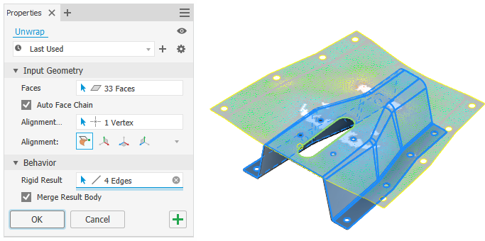

Unwrap
You can now do the following in the Unwrap command:
  • Select multiple planar holes to be Rigid.
  • Rename the Unwrap feature.
  • Align the results to the Model, or the XY, XZ, YZ planes.
Markdown card metadata
For more information, see To Unwrap Faces.

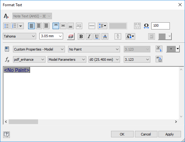

3D Annotate
You can now add Custom Properties in the Leader Text, General Note, and General Profile Note commands.
For more information, see To Work with Text and Leaders.
