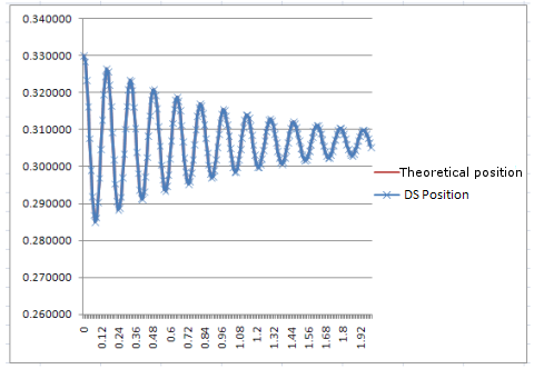

Displacement, the Mass-Spring Case
A simple mass and spring validation case.
Newton’s law:
(1)
With:
| | Numerical value: |
: position, based on time t | |
: velocity | |
: acceleration | |
= mass of the body in kg | 10 |
= spring damping in N.s/m | 20 |
= spring stiffness in N/m | 15000 |
= spring free length in m | 0.3 |
= gravity in m/s2 | 9.81 |
initial position in m | 0.33 |
= initial velocity in m/s | 0.0 |
(1) |
with  |
| | (2)
A solution for this differential equation is: |
| | (3)
A particular solution, when the system is stabilized, is for and x = B. |
Then (2)  |  |
| | (4)
The initial conditions give the value of A and : |
for t = 0.0, (3)  |  |
| | (5)
| | and |
| | (6)
Finally, (4) and (6) reported in (3) gives the equation of the displacement : |
This equation was then programmed in Excel and the results compared with the results produced by Dynamic Simulation, the results being identical. |
