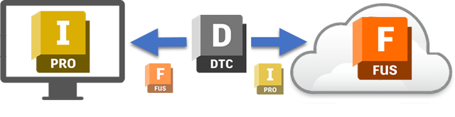

AnyCAD Workflow
Use an AnyCAD workflow to open Fusion designs in Inventor, or Inventor parts and assemblies in Fusion.
The following is required to use an AnyCAD workflow to open Fusion designs in Inventor or Inventor parts and assemblies in Fusion:
A Fusion hub. A Fusion hub is where Fusion (.fusiondesign) or Inventor files are stored so they can be shared.
Note: Fusion designs can only be opened from a Fusion hub to which you have been granted access.Desktop Connector must be installed locally on your computer. Desktop Connector creates a local Fusion drive on your computer that provides access to .fusiondesign. iam, and .ipt files in your Fusion project.
Subscription to one of the following products: Fusion, Product Design and Manufacturing Collection, or Product Design Suite.
For more information, see: To Import Fusion Files as an AnyCAD Reference Model.
