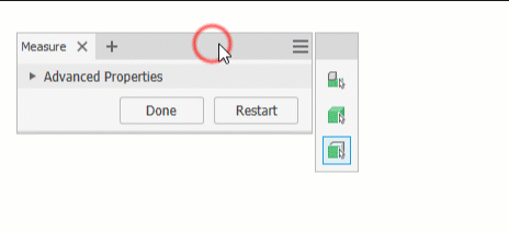

  • In an assembly file, choose a selection priority from the tool palette: Component, Part, or Edges and Faces.
    Note: The tool palette displays the selection priority options docked in a convenient location next to the property panel. The palette can be separated from the property panel and placed wherever you like. You can easily dock it with the property panel.

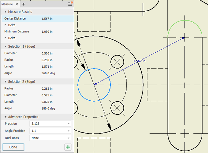

Measure Linear Distance, Length, Angle, Loop, Area, or Mass
Information on each selection displays in the measure tool panel and in the graphics window. The Measure tool panel shows all possible values for your selections as well as the result from both selections. Clicking a value in the Measure tool panel displays the selection and the measurement in the graphics window.
The value field column can be resized. Pause the cursor to the left of the value and click-drag to resize the column

  2. In Inventor assemblies only, if desired, select a selection priority: Component, Part, or Edges and Faces.

  4. In the graphics window, click to select geometry to measure:
    • Length of an edge Click to select the edge.
    • Diameter of a cylindrical face or circle Select the face or edge.
    • Radius of a cylindrical face or arc Select a face or arc.
    • Position of a point from the origin Click to select the point. The position of the point relative to each axis of the active coordinate system displays.
    • Distance between points Click to select the first point, and then click to select the second point. When you select the second point, the position of the point from the origin and delta position relative to the first point displays.
    • Distance between any 2 of the following geometries: Lines/axis, arcs/circles, splines and any type of surfaces, sketch point/non-planar face Click to select the first geometry, and then click to select the second geometry.
    • Distance between two components in an assembly Select the first component, and then select the second component. A minimum distance value displays. The minimum distance between two components can be an edge, face, or vertex.
