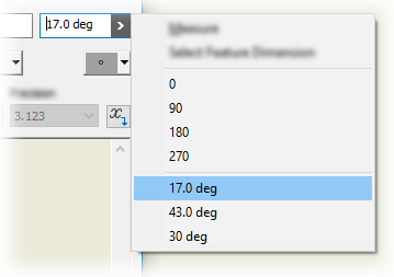

Rotation Angle, Rotate
Rotates the text around the insertion point. For example, if text is top and left-justified, the text rotates around the top left corner.
For a drawing note, click the arrow to select the rotation orientation or enter the angle of rotation in the edit box. For sketch text, select a Rotate option from the list, or create a new UCS to orient the text.
