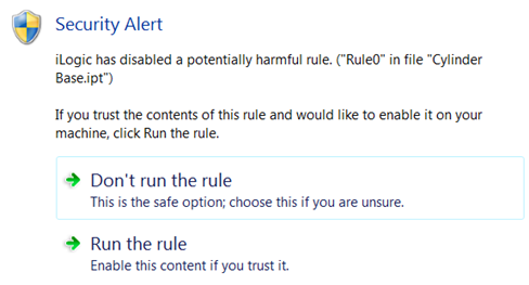

A security alert displays when you run a rule Inventor detects to be potentially unsafe. You can choose to run the rule as safe or not run the rule.
- If you select Don't Run the rule, the rule becomes disabled and will not run.
- If you select Run the rule the iLogic Security Advisor displays where you can identify all rules in the file or project that have been accepted as safe, and access the iLogic Security dialog box for additional options for managing unknown code. In addition, in the iLogic Security dialog box you can access the Disabled Rules dialog box, where you can re-enable a rule that you have disabled.
