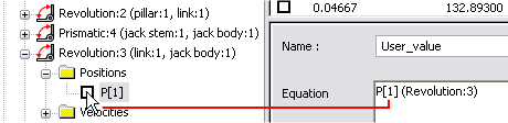

Note: The current time of the simulation is collected by the time variable.Alternatively, to enter a variable, click the box next to the variable in the Output Grapher browser.
Return the cursor to the formula text entry box.
