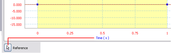

Select a reference for the curve
The reference for the curve is along the X axis. The reference is time by default, but you can change the reference for all curves except those defining imposed motions.
  1. Click Select Reference
    The Select reference dialog box opens and shows all the system variables that can be used as reference.
  2. On the Select reference dialog box, select the variable you want to use as the reference for this curve.
  3. Click OK.
    The dialog box closes and the selected variable appears along the X axis of the curve.
  4. Continue defining the curve as indicated below.
    Note: For imposed motions, you cannot change the reference variable. It can only be time, which is the default.
