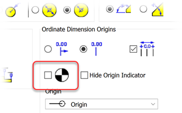

Origin Indicator
Origin indicators can now be deleted. If dimensions use the origin indicator, those dimensions are also deleted. A prompt alerts you to the dimension deletion prior to the action.
Delete the origin indicator used with:
- Ordinate dimensions
- Hole tables
- Or, the origin indicator by itself
- Ordinate Dimension Sets, if the Dimension Style
Options tab
Origin Indicator is selected.
For more information see Origin Indicator and Change Position or Appearance of or Delete an Origin Indicator.
