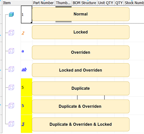

New BOM Item Status Indicators
BOM items can be overridden, duplicated, or locked. The item numbers now display differently for these conditions.
