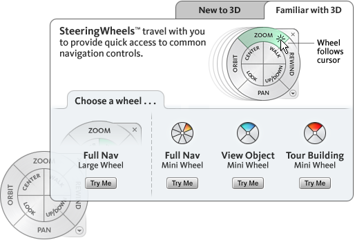

SteeringWheels, also known as wheels, are tracking menus (that follow your cursor). They combine many of the common navigation tools into a single interface. .
The primary method of interaction with SteeringWheels is to press and drag a wedge.
When you display SteeringWheels the first time, and a 3D view is current, the First Contact balloon for the wheels displays. The First Contact balloon is an introduction to the wheels.

You can control the appearance of the wheels by switching styles, or adjusting the opacity. Wheels (except the 2D Navigation wheel) are available in two different styles: big and mini.
The size of a wheel controls how large or small the wedges are, and whether labels appear on the wheel. The opacity level controls the visibility of the objects in the model behind the wheel.
