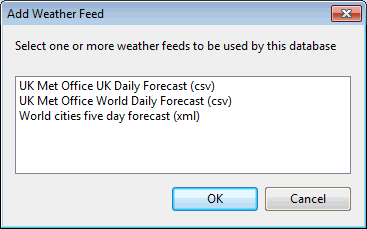

Add Weather Feed dialog
Weather feeds are used to control the switching of database objects to be used in projection runs based on the current weather forecast.
For example, different demand diagrams may be used according to the forecast temperature.
The Add Weather Feed dialog is used to select one or more weather feeds for use in the current database.
The dialog is displayed when the Add button is pressed on the Weather Feed Configuration dialog.
Field Description
Weather Feed List
Disabled weather feeds.
Please refer to the Weather Feed Configuration dialog topic for a list of all the weather feeds available for use.
This list will only contain the weather feeds that have not been added / enabled yet.
OK
Save the changes and close the dialog.
Cancel
Cancel the enabling process and close the dialog.
