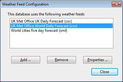

Weather Feed Configuration dialog
Weather feeds are used to control the switching of database objects to be used in projection runs based on the current weather forecast.
For example, different demand diagrams may be used according to the forecast temperature.
The Weather Feed Configuration dialog is used to select the weather feeds providing the forecast data. It also allows users to add and remove weather feeds as well as view their properties.
The dialog is displayed when Weather Feeds is selected from the Configuration menu in the Administrator mode.
Field Description
Weather Feed List
Enabled (=added) weather feeds.
The following weather feeds are currently available for use:
  • World Cities Five Day Forecast in XML format – contains UK locations and world cities
  • UK Met Office UK Cities Forecast in CSV format – contains UK locations only
  • UK Met Office World Cities Forecast in CSV format – contains world cities excluding UK locations
Add
Adds (= enable) weather feeds. This displays the Add Weather Feed dialog allowing selection of weather feeds for enabling. This dialog contains all the system-defined weather feeds that have not been enabled.
Remove
Removes (=disable) the selected weather feed from the list. This makes the weather feed unavailable for use but does not delete its properties so it can be re-enabled at a later date without a need for re-configuration.
Note:
No checks are performed at disabling time to see if removed weather feeds are referenced by any switch controllers . All switch controllers will continue to reference their configured weather feed regardless if it is enabled or disabled. Switch controller objects are created and edited in InfoWorks WS Pro, and are used to set up links to weather feeds and to set up calendar data.
Properties
Displays the Weather Feed Properties dialog for the selected weather feed. This dialog is used to set the connection properties to the server providing the forecast data.
Close
Closes the dialog.
