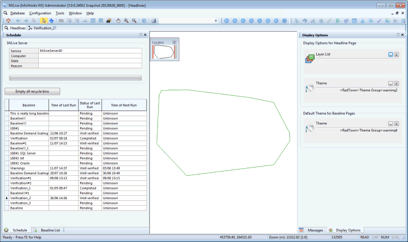

About the Headlines page in the Administrator
The Headlines page in the Administrator displays an overview map of all baselines in the database.
The Map view displays a polygon for each baseline either generated from the network extents or user-defined. Each polygon is coloured according to whether the associated baseline is enabled or not:
  • Enabled baseline polygons have a black outline with a white fill
  • Disabled baseline polygons have a grey outline and grey fill
In the map view:
  • Click an area in the map view using the tool to select the object. Hold down the Ctrl key to select multiple areas.
  • Click an area using the tool to display the property sheet for an object.
  • Click an area using the tool to display the Baseline view for the baseline associated with the polygon. If more than one baseline is associated with the polygon, a Multiple Selection dialog will be displayed listing all of the associated baselines; select the baseline to be displayed and click the OK button.
  • Right click the map to display a context menu containing options to control the map display.
See the Map view section for further details on using the map view.
