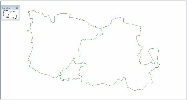

Headlines page map view
The Headlines page map view displays an overview map of all saved and enabled baselines.
The map displays a polygon for each baseline generated from the network extents. Each polygon is coloured depending on whether or not the associated baseline is enabled:
  • Enabled baseline polygons have a black outline with a white fill
  • Disabled baseline polygons have a grey outline and grey fill
Tip: Clicking a polygon using the Open associated item (Open associated item) tool displays the Baseline view for the baseline associated with the polygon. If more than one baseline is associated with the polygon, a multiple selection dialog is displayed, letting you choose the baseline you require.

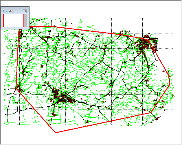

Zones page map view
The Zones page map view displays all the zones that have been defined for the currently selected baseline.
Zones Map View
Tip: Clicking a zone in the map view displays the Baseline page with a map view zoomed into the polygon that has been defined as the zone.

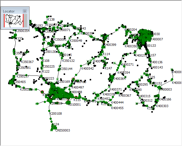

Baseline page map view
The Baseline page map view displays a detailed map of the network belonging to an individual baseline. All network objects are displayed in the map view.
Tip: Clicking an object in the map view selects the object. You can hold down the Ctrl key to select multiple objects.
Map view locator window
The locator window (displayed in the top left of the map view by default), shows a simple schematic of the entire network, with a highlighted box displaying the current location of the map view in relation to the network as a whole.
Tips:
  • Dragging the highlighted box within the locator window pans the map view to the location.
  • The locator window can be resized and repositioned within the map view.
  • You can show or hide the locator window using an option on the context menu, or by checking or unchecking an option on the GeoPlan page of the Options dialog.
