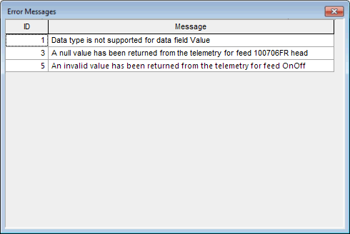

Error Messages grid
The Error Messages grid is displayed when the Ellipsis button button adjacent to the Error messages property is clicked for the current run on the Run Manager.
The Error Messages grid displays error messages which may occur when connecting to live data.
Tip:
Messages related to live data are also displayed in the Messages Window. The Messages Window is different from the Error Messages grid in that it also shows switch data error messages.
