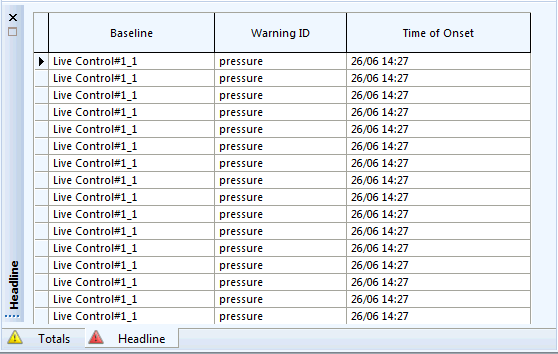

Headline window
The Headline window displays the time of onset of each Headline warning for each baseline (Headlines Page) or the selected baseline (Zones Page). The window is displayed at the bottom of both the Headlines Page and the Zones Page of the Operator. Individual headline warnings are displayed at this level because the administrator of the system has decided they are worthy of particular attention.
To display the window, click the Headline tab at the bottom of the Headlines / Zones page, or select Headline from the Window menu.
To sort the items in the grid, right click in the column to be sorted and select Sort Ascending or Sort Descending from the context menu.
Right click in a row and select Go to Baseline to open the Baseline page for the row clicked on.
All fields in the grid are read only.
Field
Description
Baseline
Name of the baseline object
Tip:
In the case of the Zones page, the Headline window only shows headline warnings for the currently selected baseline. This is why only that baseline name will appear in the Baseline column.
Warning ID
This can be:
  • the name of the warning as set up in the Warning Template in InfoWorks WS Pro)
Time of Onset Simulation time when the warning occurred
