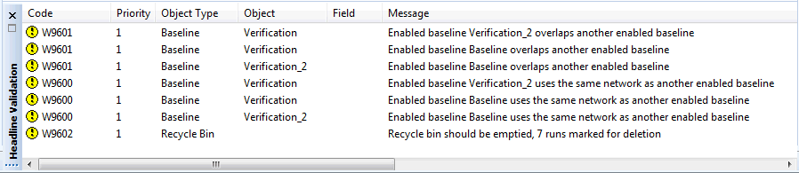

The Headline Validation window displays warning messages that occur for enabled baselines. The window is displayed at the bottom of the Headlines Page beneath the Map view.
By default the window is not displayed if there are no warnings present. To display the window, select Headline Validation from the Window menu in the Administrator mode.
Right-click in the window to display a context menu allowing the following operations to be carried out:
  • Print - print out validation messages
  • Copy to clipboard - copy messages to clipboard for pasting in another application
For each error or warning, the validation window displays the following information:
Symbol
- the message is a warning message. This message is for information.
Code The warning message number
Priority Priority level (always set to 1)
Object Type The type of object (always Baseline)
Object The name of the Baseline object
Field The field where the value is invalid, missing or outside recommended ranges.
Message A description of the problem.
List of Validation Messages
Message Number Validation Message Cause
W9600 Enabled baseline <baseline name> uses the same network as another enabled baseline There is more than one enabled baseline that uses the same network
W9601 Enabled baseline <baseline name> overlaps another enabled baseline The polygon of an enabled baseline overlaps the polygon of another enabled baseline.
W9602 Recycle bin should be emptied, x runs marked for deletion There are more than 500 items in the recycle bin.
