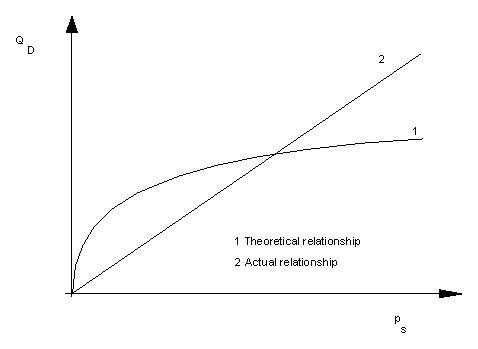

Local service pressures have an influence on demands and losses in the network. Higher pressures lead to increased consumption and losses. This is particularly true for leakage losses, where a standard relationship has been established based on the measurements in several existing water supply systems ( Leakage Control Policy and Practice, 1980 ).
1. Theoretical Relationship between flow through an orifice and pressure drop across it
2. Actual relationship between losses and service pressure derived from trials carried out to measure reduction in leakage ( Leakage Control Policy and Practice, 1980 )
A similar relationship could not be made for consumption, because many other factors are also relevant.
