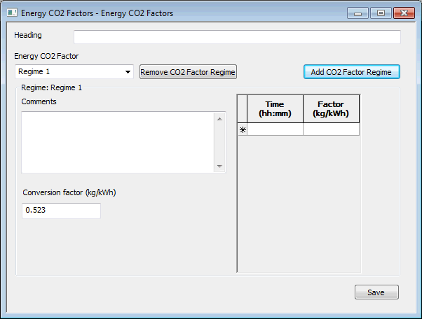

The Energy CO2 Factors data object is used when carrying out Sustainability Analysis.
Parameter Description
Heading
Title for the Energy CO2 Factors data object
Energy CO2 Factor
Dropdown list of CO2 regimes
Remove CO2 Factor Regime button
Click this button to delete the currently selected CO2 regime
Add CO2 Factor Regime button
Click this button to add a new CO2 regime. The Add New Energy CO2 Regime dialog will be displayed:
  • Enter a name for the regime
  • Select an existing regime on which the new regime will be based (optional)
Comments
Any additional notes on the currently selected regime
Conversion factor
Non time varying conversion factor for the currently selected regime
Note:
If a time varying profile exists for the regime, the time varying profile will be used instead of this value.
Time - Factor profile
Time varying conversion factor profile for the currently selected regime.
Note:
A time varying profile will override the value entered in the Conversion factor field.
