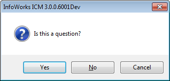

message_box
#message_box(text, buttons, icon, hard_wire_cancel) ⇒ String?
UI
Displays a message box. The title bar cannot be customised.
Icon '!' or nil:
Icon '?':
Icon 'Information':
Icon 'Stop':
Buttons 'OK':
Buttons 'OkCancel' or nil:
Buttons 'YesNo':
Buttons 'YesNoCancel':
Parameters
| Name | Type(s) | Description |
| text | String | The text displayed in the prompt. |
| buttons | String, nil | Buttons to display, one of 'ok', 'okcancel', 'yesno', 'yesnocancel', or nil (which defaults to 'okcancel'). |
| icon | String, nil | Icon to display, one of '!', '?', 'information', 'stop', or nil (which defaults to '!'). |
| hard_wire_cancel | Boolean, nil | If true or nil, when the user closes the prompt or presses cancel, the running of the ruby script is interrupted. |
| Return | String, nil | The selected option as a string, e.g. 'yes', 'no', 'ok', or 'cancel'. |
